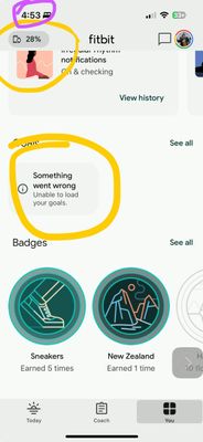

I am having the same experience. Until recently, my Charge 5 would last 5-7 days on a single charge.
Then something changed.
  • A full charge now lasts 1-3 days.
  • I am unable to set sleep goals.

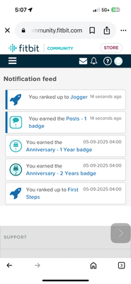

The fixes listed below were already done. The only change I made recently was to log in to the Fitbit community. I started getting emails about badges and achievements that I had never received.
I charged my Fitbit fully and wore it yesterday and last night. It’s now at 38% and won’t last the day. You can also see the issue with the sleep goals.
3 REPLIES 3
May 9 is when my battery problems began. That is the day I logged in to try to figure out why my sleep goals weren’t loading.
Battery’s going fast, kids! (This is after I reset the Fitbit, per feedback on another post.)

I know there was an issue with setting Goals in the Fitbit app. The team is aware of the issue and has been working on fixing it. I think that hasn't been resolved yet. There isn't any troubleshooting that we can recommend since the issue is on the Fitbit side. I expect that the fix will be in a Fitbit app update, so keep checking your app store and install the update when it's available to you.
