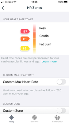

Please check one thing before you give up.  I am a healthy 66 year old with a resting heart rate of 47-48.  Here is a screenshot of my heart rate zones:

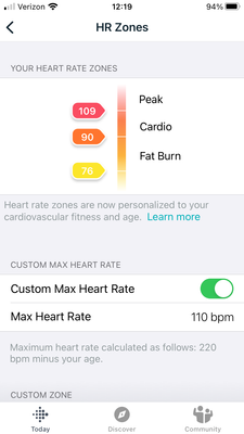

When I changed my Custom Max Heart Rate to 110, my zones changed:
Did your numbers change and did the yellow number get close to 90?  If not, then my math is wrong.  Also, I wear a Versa 3 and it doesn't have the option for these heart rate zone notifications for normal use.  @Wibby, as a Charge 5 user, can you verify that the Heart Rate Zones setting that I described is part of the Settings on the Charge 5?

It did go to 94 so you're pretty close but it hasn't made any difference to todays readings.  I will give it another 24 hrs to see if it changes from get go tomorrow.  My HR is always much higher in the morning.  I suspect it is the 10 min delay that is going to be the problem for me ...

Yes, the Heart Zone Settings change on the Charge 5 in the same way if I follow your instructions.
