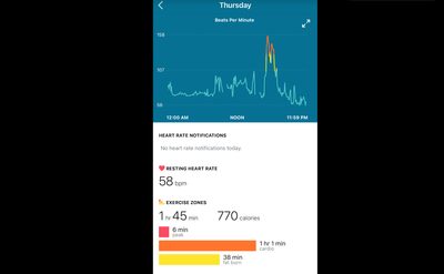

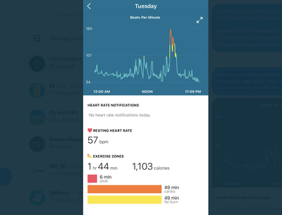

Hi there. I recently replaced my Charge 4 with a Charge 5 because the battery on the 4 had started to die.
Yesterday I did my first workout on the Charge 5 and saw the Exercise Calories burned was almost HALF of the calories burned on my typical workout on the Charge 4, for the same amount of time.
See this comparison:
Charge 4: Here is my calories burned (1,103) from my workout this past Tuesday, with 1 hour 44 minutes in my exercise zones, and 49 of those minutes in Cardio:
Charge 5: Here is my calories burned (770) from my workout yesterday, with the Charge 5, with 1 hour 45 minutes in my exercise zones, and 61 minutes in Cardio (even more!):

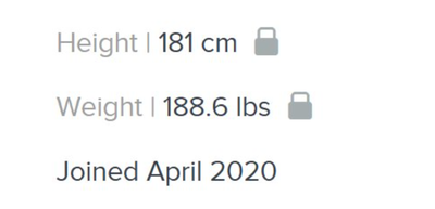

Now, I checked my personal settings and yes, they are set correctly:
Can you please help? How do I get the Charge 5 to begin tracking the calories correctly? These are clearly way too low but this is the only reason I use a Fitbit. Thank you!

To me, it would be easier to analyze with screen caps of just your workout summaries, rather than full day.
Best Answer04-24-2023 10:00 - edited 04-24-2023 10:19
Hi there. Those screen caps show the workout summaries.
The top half of the screencaps show the full day, but under "Excercise Zones" in each photo it shows just the time and calories of the workout period or periods if there's more than one.
Edit: Hahaha okay okay the Charge 5 was categorizing the 30-minute intense stairclimber workouts I was doing as "swimming". Relabelled these and numbers look normal again.
Thanks for the assist!
