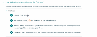

If you categorize your 'Workout' as Drive instead, you're able to edit the steps etc.
