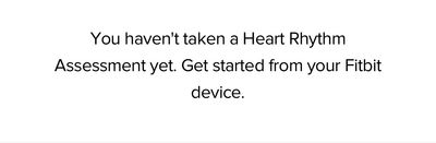

Unfortunately this is not working for me. In the you tab under Heart Rhythm Assessment it tells me to get started from my device. On my device it keeps telling me to go to the app and find the discover tab. ¯\_(ツ)_/¯
