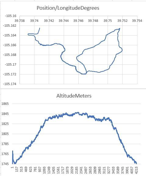

Laurie,
Respectfully, I'm going to have to completely disagree that the apps can't display the data I'm talking about. The plots below were created using data I exported from the web app into a .tcx (FitBit activity file). Clearly a time history of altitude over the course of the activity is available, and it's actually of pretty good quality. It should be no problem at all for both the mobile app and the web app to plot this data right alongside pace and heartrate.
Integrating the altitude to get total ascent/descent and thus # of floors (divide total ascent by 10ft) should be similarly simple.
-Ken
