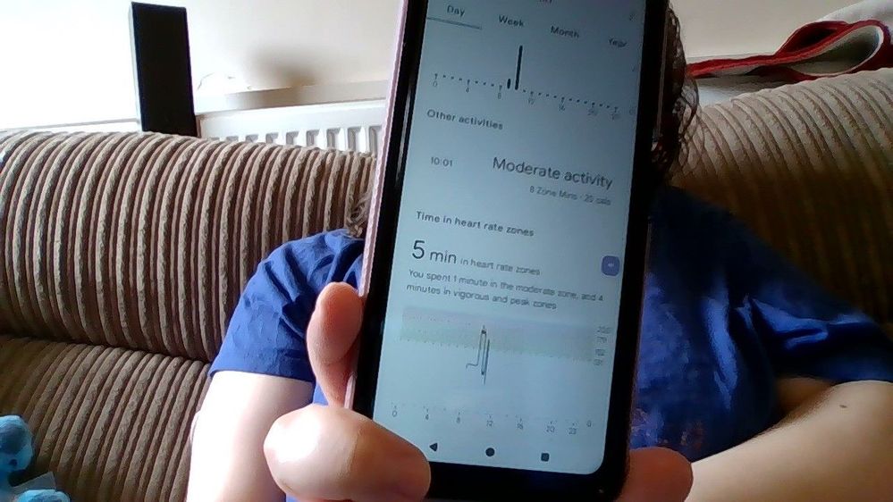

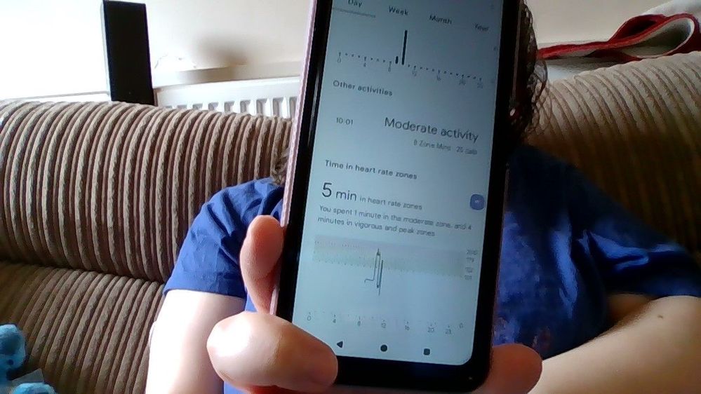

Why does my active zone minutes go up sometimes when I'm doing nothing much, like lying down on the settee or something? Like today.  Can someone tell me why?
Hello @9v9z9f
According to the provided pictures, they show that your heart rate was in the Vigorous and Peak zones. Did your heart rate graph show the same spikes?
FWIW, I've seen where my heart rate spikes into the upper ranges when I'm not actively working out, resulting in AZM and Cardio Load points. This often happens when I'm anxious or excited about something.
Yes I think it did show the same spike's Vigorous and Peak Zones.  Any suggestions on what to do next time it does it when not doing much? Can anyone tell me?
Hello @9v9z9f
Personally, I would continue to monitor your heart rate spikes that happen when you're not doing much as well as what's going on at the time.
For me, I know that when I'm very excited or anxious, I see the spikes. Since I know the cause, I don't worry about them, but do recognize them and keep monitoring for any additional unusual activity.
If you continue to see these kinds of spikes without explanation, consider confirming the spikes by doing a manual check of your heart rate or get another device, like a pulse oximeter, to confirm.  Pulse oximeters are usually inexpensive and also take heart rate readings. Then, if you get confirmation of continued spikes, it might be worth discussing them with your healthcare provider.
