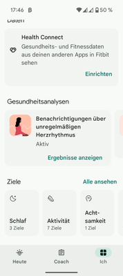

Google pixel 7 pro,
Android 15 Sicherheitsupdate 5. April 2025,
Fitbit 4.42.1,
Charge 6: 66.20001.214.24

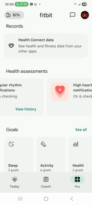

Samsung Galaxy S25 Ultra SM938U1, Software Version One UI 7.0 / Android Version 15
Fitbit apps ver: 4.42.1
Country: USA
These are the screenshots of the only tiles available under the Health Assessments Section in the You tab (and is also missing in the Heart Section of the Today tab)
I have tried everything that others here have tried & more to no avail. Clearly this crosses country borders as well as phone makes/models.. It's got to be the Fitbit app itself.
