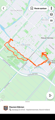

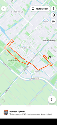

07-31-2025 12:34
07-31-2025 12:34
I have the same problem since April this year (first few months the GPS was accurate).
Now the build in GPS gives 10 - 20% longer distance than Strava or Runkeeper on my phone. .
Left is de Fitbit version, Right the correct version directly via Strava from the same run.
Feels it has something to do with calibrating the GPS in Fitbit, but how?!
