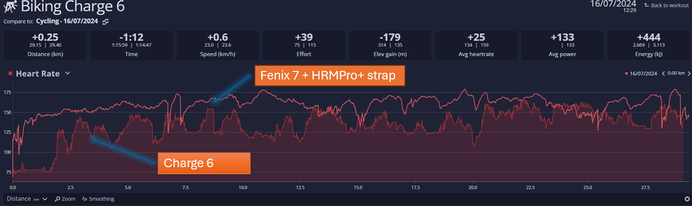

@doctordarko not Strava (I don't use Strava with Fitbit because Fitbit Strava support is useless for me, my Strava account is associated with Garmin) but here's one of recent rides HR comparison (and you can see also other differences because Charge 6 accuracy is far from perfect in other areas):
As you can see, this as well could be just a set of random numbers out of Charge 6. Not much use for me.

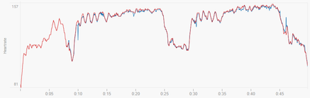

Zwift ride tonight with HR strap in red and Charge 6 in blue. Took a few tries with different activity profiles (as I do not record activities on Fitbit) but eventually settled on Aerobics (~8min mark), with just a timer and HR so I could export data for this comparison later. Anything but garbage. Go figure.
@doctordarko Zwift and outdoor are two differenr things. Outdoor depends on surface you ride one, all the vibrations, etc. I see usually no issues with indoor rides.
