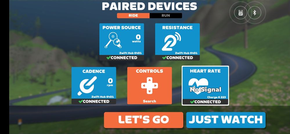

@N8teGee it's even worse than I thought. Yesterday, pushed by one of the posts in the forum, I gave a go to Zwift running on my Android mobile. I expected the broadcasting to work the same as it did when I paired Charge 6 with the Strava app but apparently this is app-dependent. So my assumption (after testing with Strava) that it will pair with a mobile phone is wrong. It will pair with some apps, but won't with others. Here's the Zwift issue:
Got it eventually working with Rouvy but there is a bit of a problem when I want to reconnect it a second time. Rouvy does what bike computers do and shows "Connected" instantly even if I'm not broadcasting HR. So unpairing from BT is the only way to get it working again.
I tried to see whether I could pair it with Zwift Hub One directly (this smart trainer can connect to HR sensors directly) but no go (not a surprise).

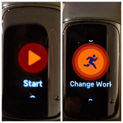

@mikey_pdx for me it didn't work. Might be different hardware. If you establish connection swipe up to change type of workout:
You should be able to change it to Spinning (there is only subset of all workouts available).

@Triletics I always forget about swiping up on the start screen. 🤦:male_sign: I'll try it next time.
