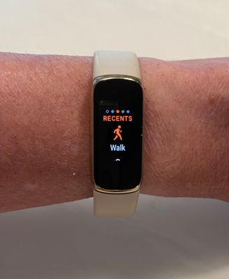

@Groggle   This screen is my Luxe.  The basic navigation is identical to your Charge 6.  Two swipes to the left get you to a screen that looks like mine.  This screen is the Exercise app I mentioned in my first post.  Mine says RECENTS at the top because I've used my Exercise app.  Yours won't say RECENTS.  I can't show you the Auto-start toggle because it isn't available on the Luxe.
On my Luxe, my screen will show other shortcut options when I swipe up on the "^" you see on my photo.  You might need to swipe up to find Walk,  Tap on walk to go to the Walk settings.  Now swipe up on the "^" and look for Auto-start.
I think you got to your photo by swiping up on the clock face.  You go to your Today stats when you swipe up on the clock face.
Laurie | Maryland

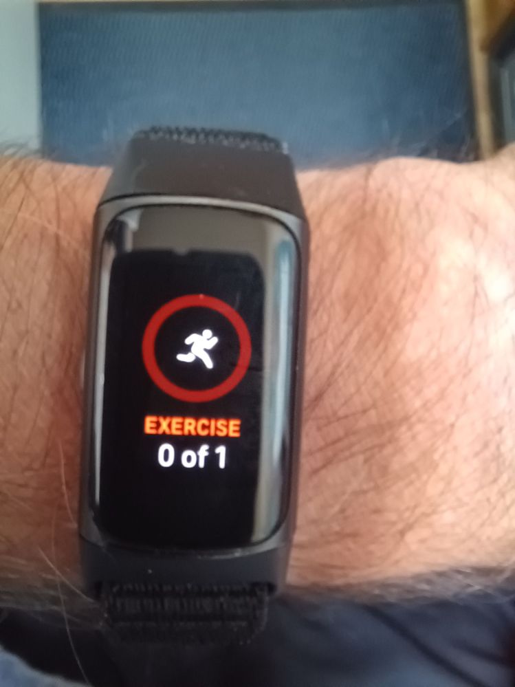

Hi
I can only find exercise by swiping up but cannot do anything with it. It won't swipe in any direction or respond to being tapped.
This is as far as I get. It will not show anything else.
I am waiting for google to get back to me about this but I somehow think they will not.
