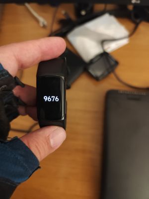

Was having the common difficulty of not being able to pair my new Charge 6 to my Google Pixel 8A phone.  Follow this advice and it worked but I would note that waiting 5-seconds for the middle push for me did not restart the Charge 6 for me, it was more like 3 seconds.  So sequence that worked for me:
  • 1 second short push and release of button on charger cable flat end - Phone responded by vibrating briefly
  • 3 second push and release of button on charger cable flat end - Phone responded by vibrating briefly
  • 1 second short push and release of button on charger cable flat end - Phone responded by rebooting with screen off for maybe 15 seconds and instead of going into "Download FitBit App" display, the FitBit app on my phone was able to find the Charge 6, it displayed a 4-digit pairing code which was entered into the app and the app then completed the pairing process
Hope this is useful to others as this seems to be a very common problem
I tried everything. Rebooting the smartphone, the charge 6, re-installing the fit bit app. When I tried to add de charge 6 into the app it says that something went wrong and the 4 digits stood in the watch for a while...
This is happening since the last fit bit app upgrade...
