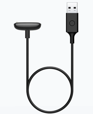

We can’t find a button on the charge cable it is the same cable as the charge 5
Best Answer05-14-2025 07:01
05-14-2025 07:01
Hi @Karen2964 and warm welcome to the forums.
I appreciate your message regarding the charging cable of Charge 6.
Regarding your question, it's the same cable for Charge 6, Charge 5 and Luxe. Fitbit Charge 6, Charge 5 & Luxe Charging Cable.
The button is this small circle near the USB end of the cable.
