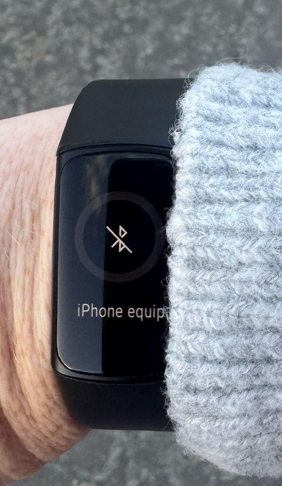

Charge 6 disconnects Bluetooth from iPhone every time I initiate exercise
This is the most frustrating thing I have ever encountered with fitbit.
Every single time my Charge6 detects a walk and starts recording (usually at 6m40s of activity), I get a notification that my Bluetooth is disconnected and do I want to share my HR with my iPhone about 20 to 30 seconds later.
Every. Single. Time.
It is beyond annoying.
I didn’t have a single problem with connectivity with my Charge4, and I’m beginning to wish I’d never upgraded.

I’m not having any issues with syncing.  It’s the Bluetooth connection for the HR and exercise monitoring.  I have to manually connect when I begin exercise.  When I’m just bimbling around, there are Bluetooth issues.  Just when I’ve actively started an exercise.
This time of year it means taking a glove off, rolling up a sleeve to tap the screen to manually tap the “share data” button on the Charge4, which is not only annoying, but it is distracting when I am trying to work out/keep splits steady etc
This *only* happens when it is in record workout mode. I get active HR real time syncing during non-exercise time.

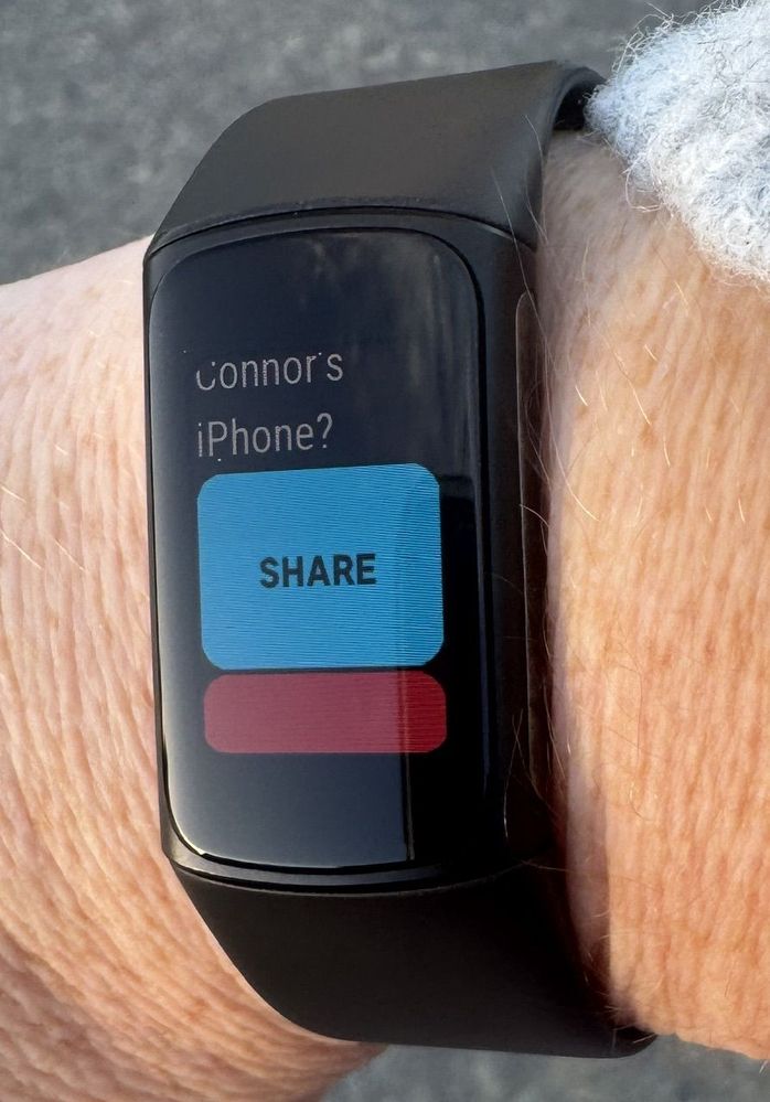

So this is what I get every single time the auto detect exercise is triggered.
Hey Casey, did you ever get help with This? I just got the watch yesterday and have this problem
No. Every single time I need to manually confirm the connection it my phone. Even if I do several walks a day. It drives me absolutely bonkers
