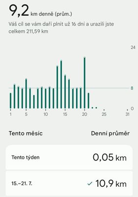

Hi. I just bought a Fitbit charge 6 one week ago. Everything was working fine. But since 2 days my Fitbit doesn’t track distance anymore. All the other things it is tracking correctly but distance stays 0km. How can I fix this?

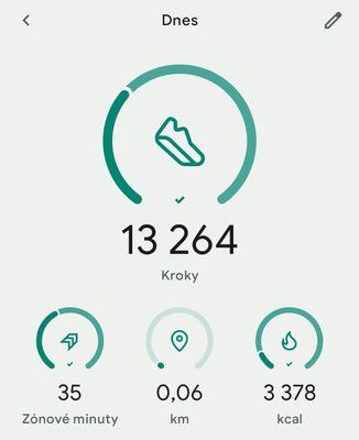

I am having a similar issue. I completed the most recent update on Sunday, July 21, 2024, and now, my Charge 6 keeps track of my steps but not my mileage. For example, I currently have 7,298 steps, but 0.0 miles recorded. Has anyone else noticed a similar issue or figured out how to fix the problem?

Hi, absolutely same problem (Charge 6 doesn’t track distance) since Sunday 21 July. I think that it happened after last app update (Android). Nothing helped so far (reset, trying to find some software/firmware update). Hope to fix it soon or compensate somehow. I do not intend to pay subscription for non-working app.
