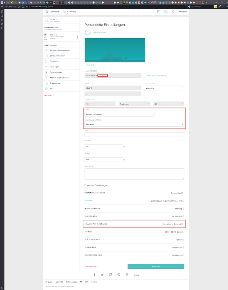

Then changed Country and State on the Fitbit page to USA New York (what is not true), then 'language by region' from german to United stated (english), but let the timezone to Berlin, synced, now its in english finally.
Lets see, how long it will stay so.
But it looks, that the Fitbit app is overwriting the Fitbit settings on the Fitbit page.

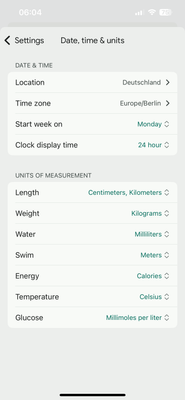

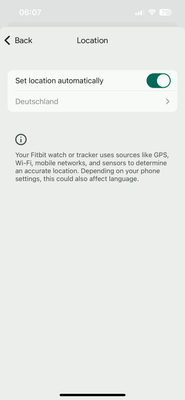

Back again, today morning was the charge 6 again in german.
Checked the settings in the Fitbit app, and location was set back to Germany, i think, because of Auto location setting:
Also the language on the Fitbit settings page has been set to german, even coutry is USA:

Hi @McLovinHawaii and welcome back to the community. Thank you for the images sent and for your troubleshooting efforts as well.
I'm really sorry to know that the issue still persists. This is not the experience we want for our customers, and I understand your feelings about all this situation.
I think you are in the right way (to disable the auto location). This is explained in the following help article : How do I change the language on my Fitbit device?

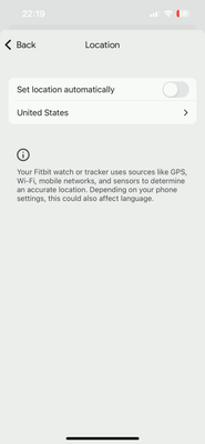

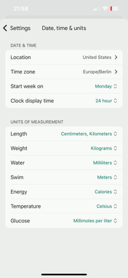

Alright, disabled the auto location and set it to United States:
Fitbit settings:
Now Charge 6 is in english language.
Started an outdoor walk, to test the GPS functionality with success.
Seems to work with this workaround.
