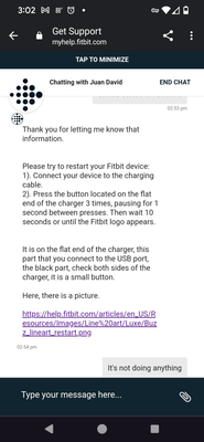

I contacted customer service. Here's what helped me.
Link to reset button image
Hope it helps!
Hope it helps!
Tried the fix.  Still doesn't do anything

This happened to my charge 6 this week and thanks to your question & the reply I’ve been able to reset it! Phew
Glad it helped!
Same here!  I read all of the instructions on Fitbit help and tried the 3 presses on the charger.  Still black with no response!  Argh... I have only had it for a week!

thank God, this worked for me too, thank you thank you
