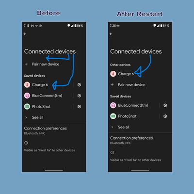

I know they are looking into the issue but here's what I observed so far if it would be of any help to the team. Without any doubt there is an unknown activity or event that disconnects the Bluetooth connection between the Charge 6 and the Phone. See screenshot below.
Restarting the Charge 6 alone does not re-establish the BT connection. For me it was also impossible to re-establish the BT connection under Settings of the Phone. I was only able to reconnect BT to Charge 6 by Restarting the phone. Sync with the app was then possible again (of course until the BT disconnection re-occur).

My (old IT guy) curiosity is leading me down a rabbit hole but I got new observation this morning that may or may not be useful in getting to a solution. It's really odd and likely cannot be duplicated that's why I decided to report it.
1) app data didn't get sync overnight as usually the problem.
2) tried manual sync; no go.
3) Switched view to my phone Setting -> Bluetooth to see connection.
4) While in BT setting, noticed the Charge 6 connection alternating on and off like it connected then disconnected for many seconds flipping back and forth.
5) decided to do a "Forget" to remove the Charge 6 saved device.
6) Tried to add back Charge 6 device : no luck.
7) Restarted the phone to add Charge 6 back; no luck.
Went back to App to view and noticed Sync is running normally.
9) Looked at phone BT setting and found that there is NO charge 6 device in the connection but still syncing. WOW.
Conclusion - Sync is working even though my phone BT does not show as connected to Charge 6. It's a very odd situation this morning. A mystery and many hours later now Sync is still going good.
