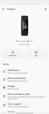

I don't I have Google Wallet tile in my mobile app so i can not set up payments with my device (charge 6). I try everything, updated device, removed my device and add it again, check bank list, restart my phone, and tile has not appeared in menu.

Hi @Miona -- the wallet app start at the today tab, and then tap the devices icon
Then tap your device (Charge 6) and then you should see the google wallet tile. If you don't see the tile, check to see that google wallet is available in your country. You mentioned that you already tried updating the fitbit app on your phone. It may take 24 hours for the wallet tile to appear after an app update. You can also try deleting the app entirely and then reinstalling it (sync your fitbit before doing that). Also, if you are in Saudi Arabia, Japan or Taiwan you use Fitbit Pay.

I do not have the Google wallet tile on my charge 6. Contactless is available in Ireland and I use Google wallet successfully on my phone.
I have uninstalled the app and reinstalled. Still no wallet option

Are you looking in the right place? You won't find wallet under the apps. In Settings, Look under google

I'm also having that issue there is no wallet under the Google detection of the settings.

Same here ;( app reinstall, Fitbit reset, pin setup , waited for more than 24 hours, still no luck
One more thing that I've done was to log in here, it's been like 5 years I think the last time I've logged in to Fitbit site.
Update:
Just as I wrote it, the wallet appears in the menu.
I think it might be that I forgot to set the pin after the last reset. And once I've set it up again, just a few minutes later the wallet appeared like in the screen above
