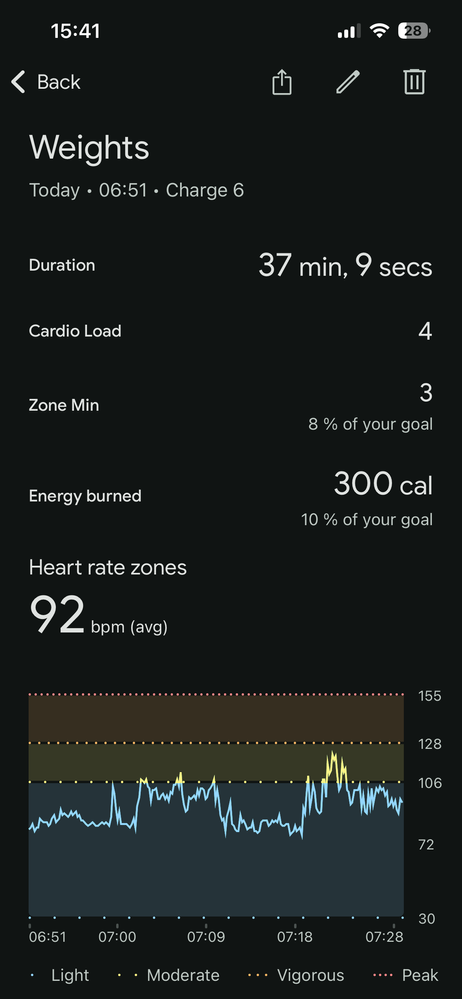

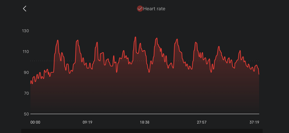

Hey together,
i'm finding, that the HR readings are not well for weight lifting sessions.
Here an exaple from my todays high intensity low volume session.
I did a warmup set for chest, then 3 hard working sets for chest.
Then one warmup set for bicep, then 3 hard working sets for bicep.
After that for my weak point an additional hard working set.
After that 2 really challenging sets for ABS.
Helio Strap on right bicep:
And here Charge 6 sitting firmly on my left wrist:
Is it only for me that bad?
How are the reading for for lifting sessions for you guys?

@McLovinHawaii no and in general, any activity that involves wrist motion will have an impact on the readings. You will see similar issues in cycling, calisthenics and many others and this isn't Fitbit only but also other watches. It's a limitation of technology. If HR is important to you during those activities then best is to look for a watch that connects to external HR monitors (you already have the armband, most sports watches can connect to it over ANT and/or BT and use its readings). Doesn't matter whether it's PurePulse or any other buzzword - wrist is worst place to wear the HR monitor when it comes to such activities and using external HR monitor is only way to fix the problem.
