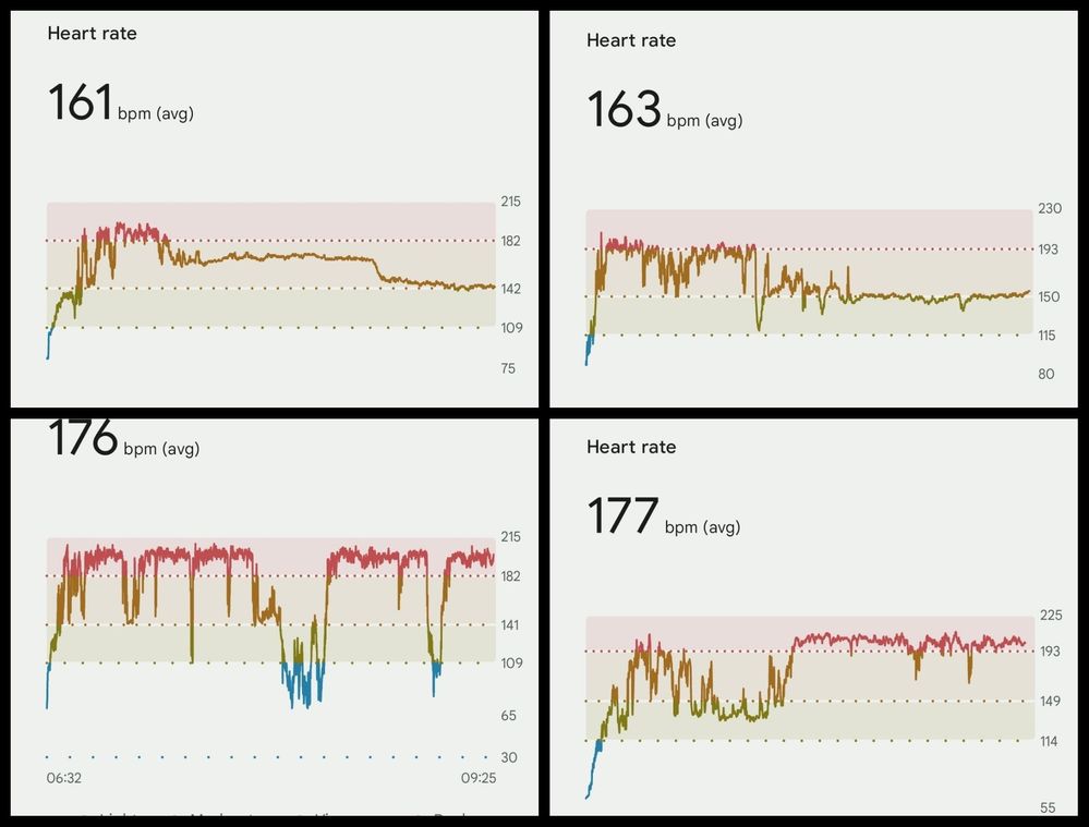

@prenaud Charge 6 happily locks to your cadence. It happens all the time to me, no solution.
Here's what it looks like to me:
Just 4 randomly picked runs (all HR above the Peak is wrong). Sometimes it stabilises, sometimes it doesn't. My cadence is between 195spm-200spm, and that is often read as HR by Charge 6. On an indoor bike that happens a lot less, usually, it locks onto cadence during off-seat intervals when a whole body moves up and down but it does happen.

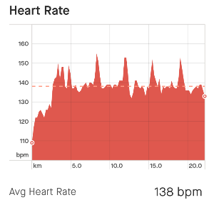

01-29-2024 08:23
Weird. This is what my last sessions look like. It even went down to 60 today.

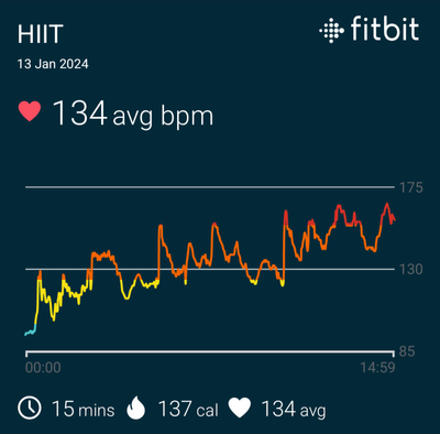

That looks very much like it going very wrong. I've attached a 15 minute HIIT for comparison. You can practically see my resting points in the graph.
I do hope you get your sorted.
