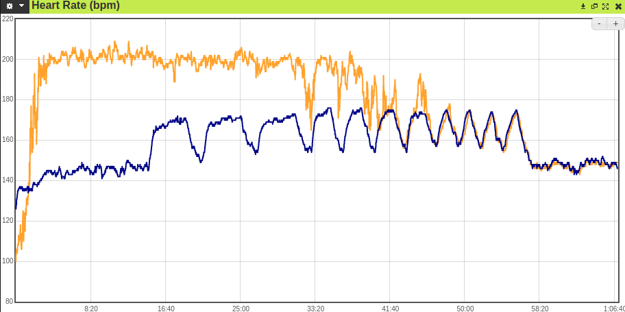

Charge 6 tends to see arm movements as HR. What kind of cardio equipment we are talking about? I see that problem constantly when I run. My yesterday run (orange - Charge 6, blue - chest strap):
It gave me an average HR of 181bpm while the real average is 158bpm. It's because it picked up my cadence of 200 steps per minute as HR. Sometimes it "detaches" from steps and starts showing it correctly (you can see that the last 3 reps and cooldown are nearly perfect). If you move your arms (elliptical, treadmill?) with such cadence it may be doing the same thing.
