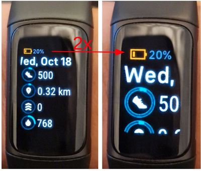

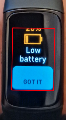

The battery indicator is almost invisible without magnifyingThe battery indicator is almost invisible without magnifying

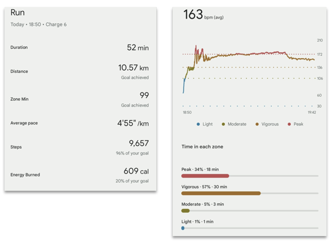

I took Charge 6 for the very first run. Since I'm not feeling 100% so decided to do a progression run workout well under my threshold. Also, this test was supposed to show whether I could rely on the built-in GPS (the short answer is 'no').
The structure of the workout was the follows:
In short, it means that each 10-minute interval required running slightly faster (outputting more power). The transition was quite smooth. Intervals 1 and 5 were a very easy warm-up and cool-down. Total of 50 minutes workout.

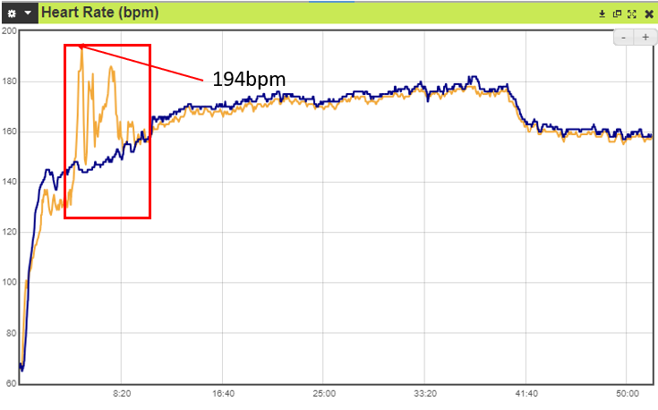

The next thing to look at is the heart rate. I compared it against the Garmin HRM+ chest strap (orange - Charge 6, blue - HRM+):
The first 10 minutes (pretty much the entire warmup) were very problematic for the Charge 6. I picked this kind of workout for a reason. It doesn't involve short intense intervals so it should be relatively easy to track. Each interval is 10 minutes long and assumes a steady pace within the specified interval range. So nothing tricky to track. After the warmup, Charge 6 picked up the right HR and followed quite closely the chest strap. However, it's visible the orange HR is slightly below the blue one but for a little tracker, close enough. I'm not quite sure why the first 10 minutes didn't work well but I think the tracker locked onto my cadence. The highest HR (194bpm) is quite close to my running cadence (195spm). It's not too bad if the workout is long (1hr+) but for short 15 to 20min sessions if the first 10 minutes are inaccurate then it's hard to call the HR reliable. Depends on view. Personally, I wouldn't care much (my running workouts are by the power not heart rate). Despite the initial hiccup, there's only 1 beat difference between the chest strap average (164bpm) and Charge 6 (163bpm).
I use a custom heart rate zone set to my anaerobic threshold but there is no time in that zone anywhere specified. Neither elevation gain (but that is obvious due to lack of altimeter).
I wish one day I could say that Fitbit is a great brand for runners but so far I can't. Charge 6 isn't crafted for runners. There is no option for manual laps on the tracker (I wanted to mark a lap for each interval but found it impossible).

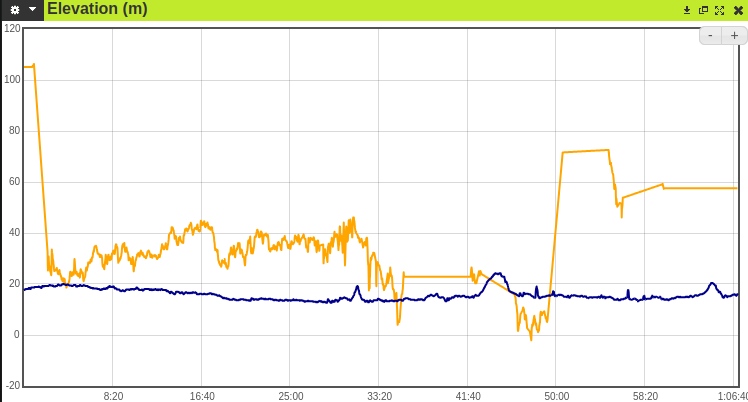

Run #2. 45'@easy(steady pace), 7x(30"@all-out, 30sec@recovery  ), 1'30"@easy, 6x(15"@all-out, 15"@recovery)

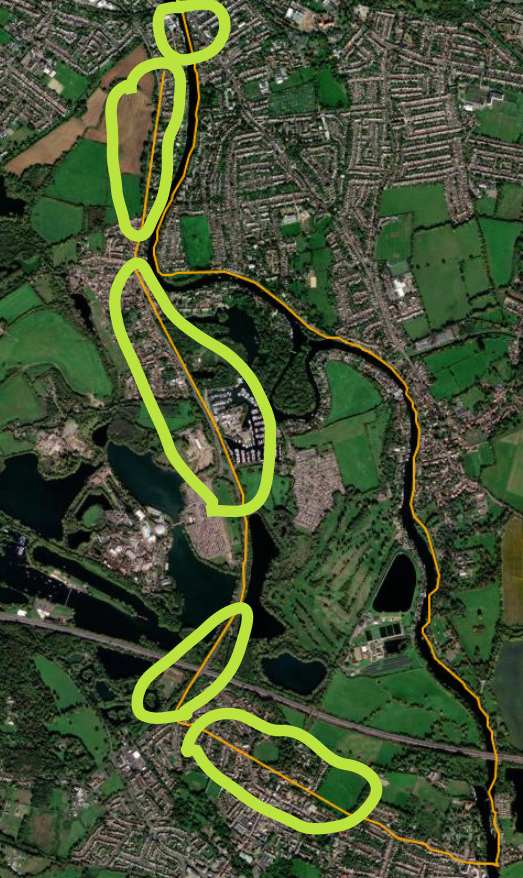

Today, I used Dynamic GPS which worked slightly better but I lost the GPS connection multiple times. I'm not going to sugarcoat it. It isn't good. It's just bad:
green areas are when GPS got lostgreen areas are when GPS got lost
It's quite a significant portion of the route (the entire course was 13.28km). The good thing is that Charge 6 captured a little more than yesterday. The bad thing is it kept dropping the GPS connection randomly. Those drops are visible on the elevation chart (yes, the data contains elevation, surprised?):

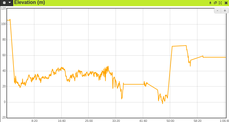

Each straight line means lost GPS. Interesting here is however that despite the lack of an altimeter, there is an elevation inside the TCX file! The elevation chart is not shown in the Fitbit app and I'm not sure what is the source of the elevation. It's certainly incorrect if compared with the right one (blue, this route is flat as a pancake):
This may be coming from the GPS data (hence it disappears when GPS is gone) and that would explain the lack of precision (the altitude from GPS is very inaccurate and may vary even within the 50m range). This may be a reason Fitbit decided not to display it and not to show an elevation gain. I don't know that. I guess better not to have an elevation chart at all than to get it horribly wrong (and the same could be said about built-in GPS).

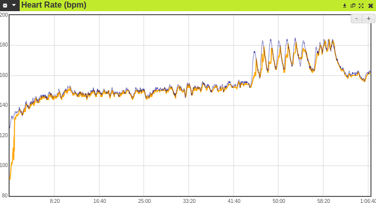

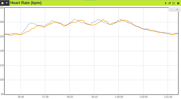

The heart rate on the other hand positively surprised:
Again, I tested it against the Garmin HRM+ chest strap and the first 45 minutes (steady state)  did work incredibly well. Only the first minute or so matches less but that isn't a problem. The first set of 7 reps of 30sec sprints looks less accurate but it's better than anything I have seen on any Fitbit watch so far:

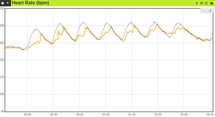

The intervals were short and Charge 6 couldn't fully pick up the spikes but did some effort to do so at least. The interesting bit is that the spikes seem to follow a pretty similar pattern: rise, flat, rise, drop. Not too bad. Short intervals were impossible to track for my Sense and Sense 2.
The next set involved 15sec reps all-out which left even less time for HR to elevate:
There is a bit of delay but still Charge 6 does quite a good job trying to detect elevated HR. It managed to detect max HR very close to the chest strap:
Chest strap vs Charge 6:
This is pretty good for a little tracker and I am impressed. There will be almost certainly a problem with weight training though due to the nature of short sets and wrist movement) but that is yet to be checked. For me, the evidence of accuracy will be presented by outdoor cycling which I have never managed to capture correctly with any Fitbit.

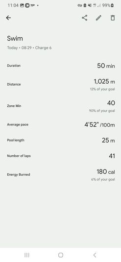

Swimming. 1600m as 200m/FS + 3x400m/FS + 200m/FS
The tracker didn't die the first time in the pool which is great 👍 Yet, I am not impressed at all. Today, I swam 5 sets of freestyle (no drills, no kickboard, nothing tricky to track, good push-offs and flip turns). Total of 1600m with longer rest times between sets and shorter rest between reps of middle set.

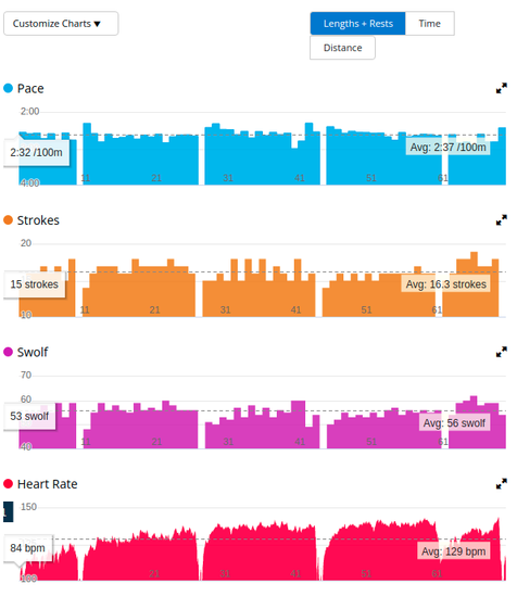

Overall structure (from a different watch):
Moving pace 2:37/100m.
So here are the Charge 6 tracking results. I tracked it using the Swim exercise option:
There are several problems. First, the total distance doesn't match by a lot. It should have been exactly 1600m but ended up with 1025m. It's undercounted by 35%. This is a huge inaccuracy. Number of laps should be 64 and is 41. That means the Charge 6 didn't detect the new length nearly 20 times!
Another problem is that there is no breakdown of laps. I know that the laps had to be enabled on my Sense to see such a breakdown, however, I can't find such an option anywhere on Charge 6. That sounds like another downgrade. Now, there's even less data than before. Very disappointing and like with Sense 2, I'm not quite sure whether it's even worth it to take Charge 6 into the pool and risk potential water damage when there isn't much benefit from the tracking. Tracking lengths didn't work, there's no laps breakdown, and heart rate isn't there either (but that's common for all Fitbits). The tracker shows only a timer during swimming so there's not much use for it in the water (still users will need to count lengths in head).
If you want Charge 6 to track your swimming then it's probably not the right choice.

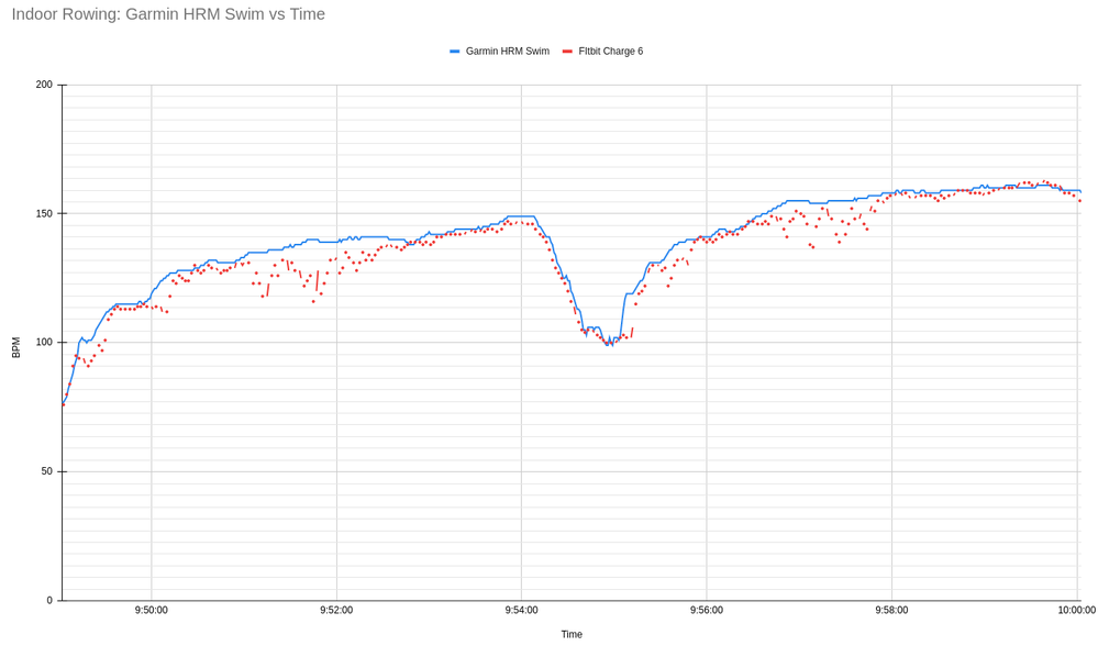

Rowing Machine. 11min workout, Concept2 rower
After swimming I went to do a very short session on the rowing machine. Since Concept2 is listed as "tested" for the HR broadcasting feature I gave it another go just in case it started working. Nope. The tracker wasn't even detected by the rowing machine as before. So I connected my chest strap to the rower (no problems). I should mention, my chest strap broadcasts via ANT+ and BLE. I tested BLE first to make sure the rower has it enabled (some gyms disable BLE connectivity on the equipment). It did connect but I prefer to use ANT+ (more stable and quicker to connect).
The heart rate tracking wasn't too great on Sense and Sense 2 when I was using the rowing machine (that's an understatement). The Charge 6 wasn't perfect but in most cases acceptable. The rowing machine does a lot to the wrist and that may affect readings. I used the Garmin HRM-Swim chest strap to validate Charge 6 data (it's a swimming chest strap but the only difference is the material the strap is made of so it "sticks" to the skin during strong push-offs, accuracy is the same as for the HRM+).
The structure of the workout was 5min@moderate/5  + 1min@rest  + 5min@hard/10  . Watches haven't been paused during rest. I just want HR to drop before the harder interval.
What is very noticeable is that the readings are not obtained every second. Previous models are known to read HR every second during exercise. In the chart above it's seen that it's not the case. Datapoints are scattered and not continuous. It may be better for accuracy if it's an algorithm that tries to detect and correct errors. I have seen such a thing on Garmin during swimming (if a user decides to use wrist HR during swimming). The accuracy is a hit-and-miss in some areas, but overall I'd say it's acceptable. I must say here that I keep comparing relative accuracy considering Sense and Sense 2 and these two watches never came this close to the correct results. So it's not great but not the worst either. If I could give it a score, maybe 7/10 🙂
There is not much else to compare since the rowing machine doesn't track other metrics like stroke rate, etc. (Concept2 connects as a smart trainer to my other watch and gathers all the data but that can't be compared).
So far not too bad. I think it's still a better device than Sense 2 and Versa 4. Swimming seems to be slowly abandoned by Fitbit (who knows, maybe the next device won't support swimming at all). But overall it's a decent basic fitness tracker. Slightly unfinished but that is a domain of all Fitbit products 🤷 so hopefully, there will be an update improving certain areas.
I need to find some time to test it on the bike though. This is going to be "make-it-or-break-it" for HR tracking 😉

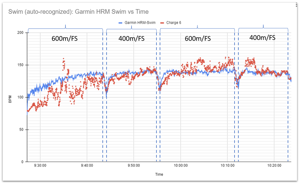

Swim (auto-recognized): 2x600m/FS + 2x400m/FS
My second swim with Charge 6. This time I decided to let Charge 6 detect my swimming workout. In the app settings, I reduced the auto-detection time to 10 minutes (from 15) as I wasn't sure whether it was going to pick it up. I never use auto-detection so I'm not sure whether I need to swim 10 minutes constantly so the watch can detect it. I don't know if I do shorter warmup intervals the tracker would detect my swimming. Never used Fitbit that way. Just to be on the safe side I decided for a longer first interval and swam 600m at a leisure/warmup pace so it could be autodetected.

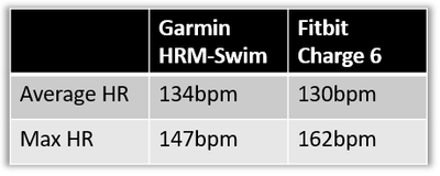

When swimming is autodetected, Charge 6 will record heart rate(that is not the case for some other Fitbit watches like Sense and Sense 2). If I already got a heart rate then it makes sense to see how well the Charge 6 HR sensor works in the water:
This isn't too bad for a tracker that isn't supposed to track HR in the water. It follows the general HR trend. Intervals 2 and 4 seem to be captured best. The worst data quality has been registered for the very first long interval. Again, as previously found, the data isn't recorded every second. Looking at the data it seems to be recorded (mostly, not always) at every 2s interval. Short rests between main intervals show a very similar drop in HR to the chest strap (which is a dedicated chest strap model for swimmers).
There is a huge discrepancy for maximum HR but somehow the average HR lands very close. The standard deviation is double for chest straps (HRM: 9.19, Charge 6: 18.70) which isn't good (Charge 6 HR is more "noisy" which is visible on the chart) but the median is 137bpm for the HRM-Swim and 135bpm for Charge 6. This is pretty close. These numbers indicate that despite the noisy signal overall trend is preserved. I'm curious to see whether this is just a fluke or indeed Charge 6 sensor does a decent job in the water. Mind that testing other Fitbit devices with HR during swimming, the results weren't even remotely similar to this. It's a far cry from the quality of a chest strap but this tracker isn't supposed to measure HR during swimming and what I see here isn't bad.

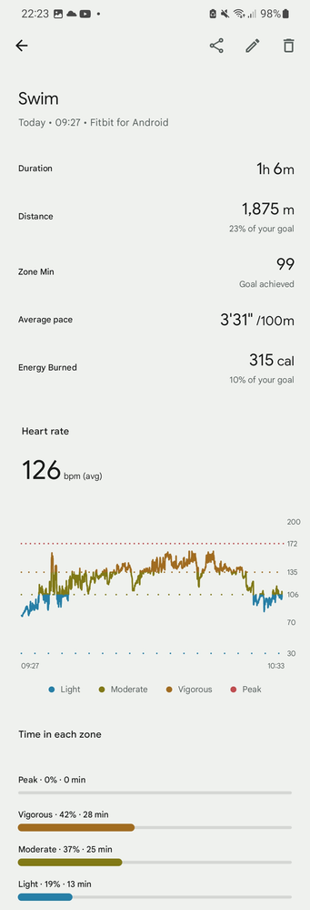

Now, let's look at the final data:
The distance is 1875m. It means Charge 6 is again a few lengths short. Not as many as last time but it is still significant. It should be 2000m so we are 5 lengths short.
Looking at the average HR I must mention one thing - in my analysis, I took data from exactly the same timeframe for both devices. This is because the actual swim took 57 minutes but I am unable to tell the tracker I finished swimming when using the auto-detect feature. Hence, lower average HR on the screen than the one from my analysis.
Swim exercise adds AZM. Regardless, of whether there is HR or not. If we track swimming from the tracker, it will disable the HR sensor but will still grant AZM. It is some mysterious method of gaining AZM which I have no idea how it works without HR. If HR is there, the AZM doesn't seem to be derived from HR. 28x2 + 25 = 81AZM while the app granted 99AZM. Strange, but it's Fitbit.
If auto-detection works also with shorter intervals at the beginning (ie. 5x100m) then it may be the best way of recording the swimming with Charge 6. Starting recording manually from the tracker doesn't make much sense if the tracker itself shows nothing of use on the display. Letting auto-detect, as a bonus we get HR data. The distance is wrong regardless of the method used.
