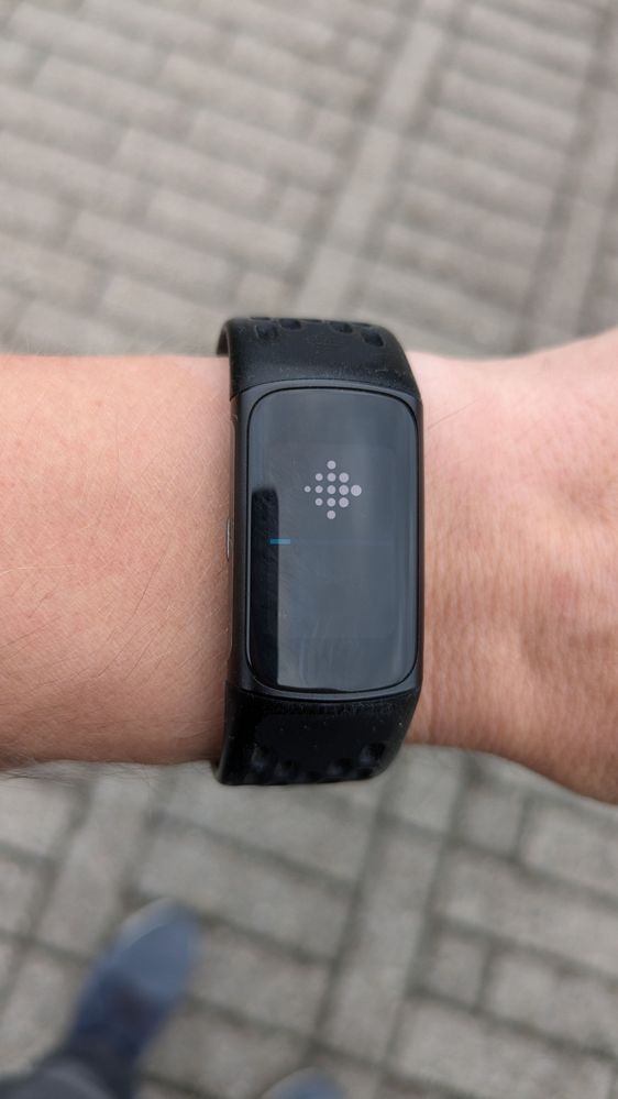

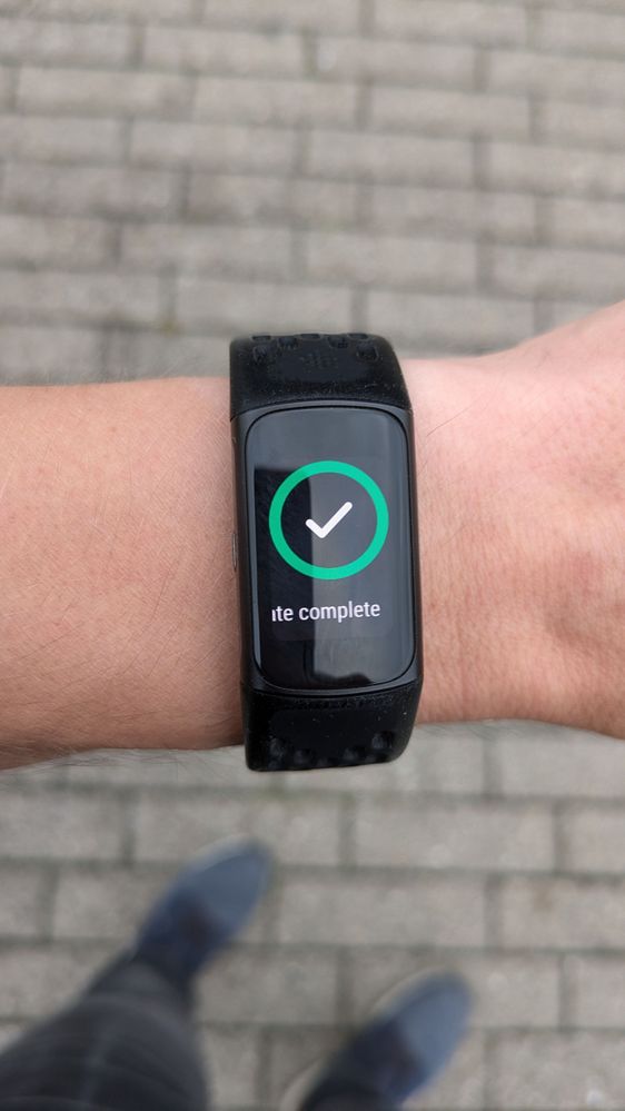

My experience is that the updates happen several times a week and it is very clear that it happens shortly after opening the Fitbit app.
What actually happens is that the watch vibrates and shows a message that it has been updated along with a progress bar - I suppose that it is restarting to apply the update.
What actually happens changes between two scenarios. The first is that the watch vibrates and show the message "Update complete" inside a circle - I suppose that it is restarting to apply the update. The second is that the watch vibrates and shows no pulse.

It's been a while now and in the meantime I got an actual real update for my tracker. This update was announced in the app with the option to install immediately or postpone, just as @Rich_Laue writes.
Hopeful that this update would solve the problem, I installed it immediately (so I am now on 66.20001.210.26), but to my disappointment I still experience the behaviour described in OP.
I managed to take a few pictures of the tracker when it does this - see below:
