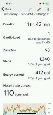

Why has this not been fixed yet? It has been weeks people have started reporting this. All the metrics for the exercise are being tracked, but it calculates a 0 cardio load. I get more cardio load making breakfast than I do with almost 1 hour of cycling. I'm not exaggerating - look at the second screenshot below!

No Cardio load for dance? Intense zone minutes. 1 minute cardio??? Please fix this google!
