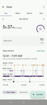

Since 3 days now, all I have as result of sleep is awake, agitated, and total sleep time. Its not broken down in sleep types, nor do I have access to the hours where the type of sleep changed. Very very dissapointing . Whats going on with fitbits anyway. Worst since its with Google it seems.

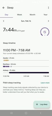

I have the premium version, and I also stopped getting sleep stage detail after Feb 15, 2025, replaced with a dumbed down version. A disappointing change to app? I agree, Fitbit has gone downhill si ce the Google acquisition, what a bummer. I have been a Fitbit user for 15 years, but will likely move to Oura ring or Whoop if this continues.

Hi @kzagozdon, thanks for stopping by, I hope you're doing well.
I'm sorry to see that you haven't received a detailed sleep log. On the other hand, i really appreciate the loyalty you have shown to our brand. Thanks for the screenshots.
The second screenshot you posted includes your sleep pattern (which shows your time asleep, restless, and awake). This summary doesn't show sleep stages due to certain reasons. For more information about it, i recommend to read our help article What should I know about Fitbit sleep stages? specifically below the subtitle Why aren’t my sleep stages showing up today?
