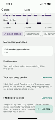

I don’t see sleeping heart rate. It has never showed after the update. Before the update I could see the data.

@KateKK1 Thank you for the screenshot. You did all the troubleshooting I would do. I'll flag your post to get a moderator to help you. You might get a faster answer by contacting Support. Tap on your profile picture/gear icon in the upper right > Help & Support > Contact Customer Support.
Your screenshot clearly shows that you have other Premium sleep features, like Restlessness and your Sleep profile information.

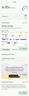

Was this ever solved? I’m dealing with the same issue as a premium member but the replies don’t show any actual fix for it. I use this mainly for my heart rate and with the major decline in the UI/design over the last year, I will switch to a different product if there is no fix, it’s not worth paying for.

Me too. Sleep score is very important to me. Hope it's fixed soon
I agree. Sleep score and heart rate are why I have and pay fit bit premium.

Hello @rootabaga & @trishypoo
I also didn't get my sleeping heart rate data yesterday (03 Dec 2024) first thing in the morning, which meant that I didn't get a sleep score. However, I noticed that my sleep heart rate graph & sleep score did show up later in the day.
I saw that there was a temporary Fitbit server outage yesterday that affected syncing. The short outage could have affected sleep scores.
Please let us know if you're still having issues with your sleeping heart rate tracking.
