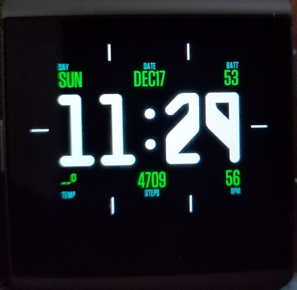

So frustrating, I love so many of the new faces, but their customizations are not working. This list sadly includes, but is not limited to:
Timebomb, LCD Clock, Simple Corners, Clear Beam, Isotime, Highlight, Clean & Smart, and Unicorse. Even Pies and Bars does not change the date format.
I guess I'll stick with those that work and adjust settings great, like pWeather, Cobblestyle, and Nothing Special. Metro Clock works great, but does not have days in English.
I can't imagine I am doing something g wrong since it works correctly on so many.
