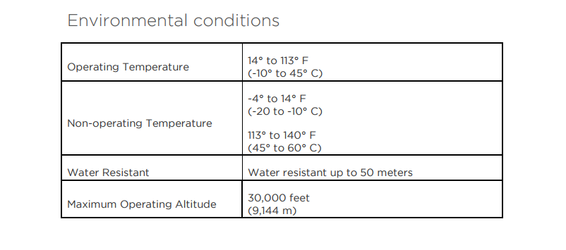

Hey there @Homemade, it's great to see you around the forums! I'm posting below the environmental conditions for Fitbit Ionic:
Hope this helps!

@MarreFitbit: of course your post does not help.
It is clear from the problem description that the original poster is using Fahrenheit for the temperature scale (else warming up to 65 would be, well weird).
Which is well within the operating temperature range and therefore it does not give any clue at all why his/her Ionic is not charging.

Exactly, my point was that your fitbit should also be charging within the operating temperature range.
Posting the operating temperature tables was pretty useless, since it was well within the range.

@NoFearJB according to chart in the above stream the non operating temp range is -4 to 14 degrees farenheit. You may want to cover the ionic with your sleeve if you are out running in extreme cold.
