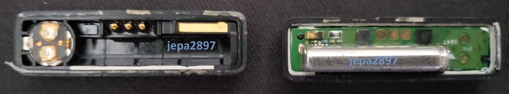

So going through this problem many times, I believe it's just wear and tear that could be causing this issue..
I've noticed that when I fixed the issue and then wore it in the shower, it would begin to malfunction again, the same night. When I tried resetting the device for the entire day, didn't work. When I tried troubleshooting it couple days later, it would start working; however, it wouldn't charge to 100% and it broke down after 1 hour. I finally gave up and was able to pull apart the device easily and realized it was held down by thin glue:
So, I assumed moisture from showering and swimming repeatedly for 3 years was the problem. I guess nothing last forever lol.
Ended up finding the Flex 2 on Ebay, and it worked perfectly well. So, it can't be the software and the charger, it gotta be the 24/7 heavy use of the pebble.
