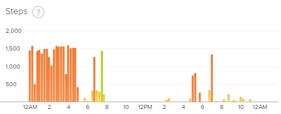

I've been trying to calculate my walking stride length (actually step length, but Fitbit calls it 'stride length') to improve the accuracy of the distances that my Fitbit (Charge HR) shows.
I did a 20 mile walk in July so I have been using the data from that to try and calculate the stride length. I tracked the walk using both my Fitbit and RunKeeper on my phone, and have selected a just under 6km segment of the walk where I did not take any breaks to use in my calculations. I wanted to use this data as I figured over such a large distance, my steps should have been roughly what they would normally be.
The issue I am having is that my calculations show a step length of 35.72 inches. I am a 5 ft 7 female, in ok but not fantastic fitness. From everything I have read online, this step length seems enormous. I am not conscious of having an unusually long stride length.
Walking kilometers 22.22 to 27.91 of the walk took me one hour, in which time my Fitbit tells me I took 6270 steps. So 6270 steps in 5690 metres, which gives a step length of 0.9075metres or 90.75cm. Converted to inches, this is 35.72. Have I missed something here? I am really struggling to understand why my step length seems to be so high. Does anyone have any suggestions?
I have added a screenshot of the steps chart from the Fitbit Dashboard. The walk was done at night (starting 10pm, finishing around 5am), hence the weird times! Kilometers 22 to 28 were between 2:45 and 3:45am.

Unfortunately you cannot do what you are trying to do with the data you have. There is no way that any app, or tracker can accurately calculate your stride length. Step counts are probably inaccurate, distances are roughly calculated.
To set your stride length you need to find a accurate distance you can walk. I used a 100 yard football field. I walked the known distance 3 or 4 times and counted my steps. Turns out each time was the same step count. Then I used that to calculate my "stride" length.
But keep in mind that when you walk, your stride length changes. It depends on how quickly you walk, vs power walking. When I power walk I take short stride steps. The more steps, the faster the walk. So when I stroll, or walk around 2-3 mph, or powerwalk at 4.5 mph, each stride length is different.
You are not a machine, so each step is not the same.
