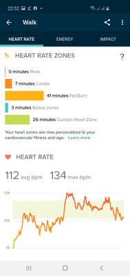

Any ideas why when I go for a short walk - only half of it appears to be tracked on the energy side?
Ill upload pics shortly to show as a pic shows it wayyyy better

Go to your HR stats for that chunk of time - what does a pic of the same time span show for HR graph?

Its actually uphill for the last 10 mins.
I weigh 212lb and HR peaked at 120 but average is around 110.
Does that make it more likely to be correct?
It all confuses the *outta me 😔

Update. With autotracking on this is what i get
I weigh 15st and pretty unfit lol
Now if I manually tell it i went for a walk - gave it the times and distance etc that it asks for this is what I get. This is on the same route also so everything is equal
so which is closer to being correct?
Using that formula in previous post its closer to the 250 calories - but why - if i auto track - it blows up?

Because it's using HR-based calorie burn initially and while that can be decent estimate in good circumstances, and potentially better than any other formula - it's not for walking & running where formula based is more accurate.
That's where the 257 came from - formula for pace and weight.
So out of shape will certainly throw HR-based off.
Eventually you'll likely get as fit as the HR formula thinks and the 2 methods will match.
