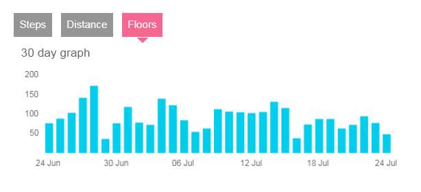

I find floors are pretty consistent for me, at least at this time of the year (summer, mostly high pression). Here are my steps for the past 30 days:
And here are floors for the same period:
My "floors" come mostly from walking in hilly surroundings. Higher step days translate in higher floor counts, and inversely. Floors are not a major Fitbit metrics I monitor, but I wouldn’t dismiss them as entirely useless.

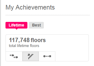

Oh, and I like to boast about my lifetime floor count:
It’s more than three times the highest badge Fitbit currently knows (Satellite = 35,000 floors).
