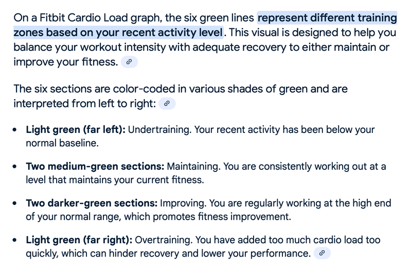

Can someone explain the graphic for "your past 7 days training". A line with 6 blocks of colour and a dot which presumably represents your activity or fitness. What do the colours represent?

Hi @Consul. This is Google's explanation:
The black dot is you.

Hello @Consul
If you are asking about the position of the black dot, that represents where you are for Cardio load based on your last 7 days of activity and your fitness goal.
For example, I have my Cardio Load fitness goal set to Maintain. I'll look at where my dot is on the line graph. If it's in the Maintain region, then I'm doing good. If it's in the Over-training, then I need to take it easy to get my dot back into the Maintain region. Same for Under-training.
I pay more attention to where my dot is on the line graph than always trying to meet the suggested Cardio Target Load range.
Please let us know if this answered your question.

I THINK the graphic is a display of Acute to Chronic Work Ratio (ACWR).
Acute Work is your average daily Cardio Load for the last 7 days. It's a measure to determine if you are over-training and raising your potential for injury.
Chronic Work is your average daily Cardio Load for the previous 28 days.
ACWR is calculated by dividing your Acute score by your Chronic score.
The ratio is interpreted by these guidelines.
0.8 - 1.3 is the sweet spot. You should keep your exercise intensity in this range.
>1.5 is the danger zone. The potential for injury is significantly higher.
<0.8 is under-training and you may lose fitness.
There are 6 zones on the graphic. The center is ACWR of 1. The middle two bars are the sweet spot. The next two bars are indeterminate zones where could potentially be over or under training. The outer bars are in the over and under training ranges. The dot is your current ACWR.
