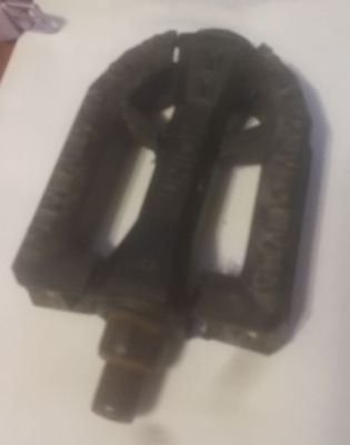

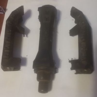

Using the pedals that it came with, I bought a second set of pedals and modified them into handles.
Crank Handle (0)
Crank Handle, before
Crank Handle (1)
Crank Handle, after
