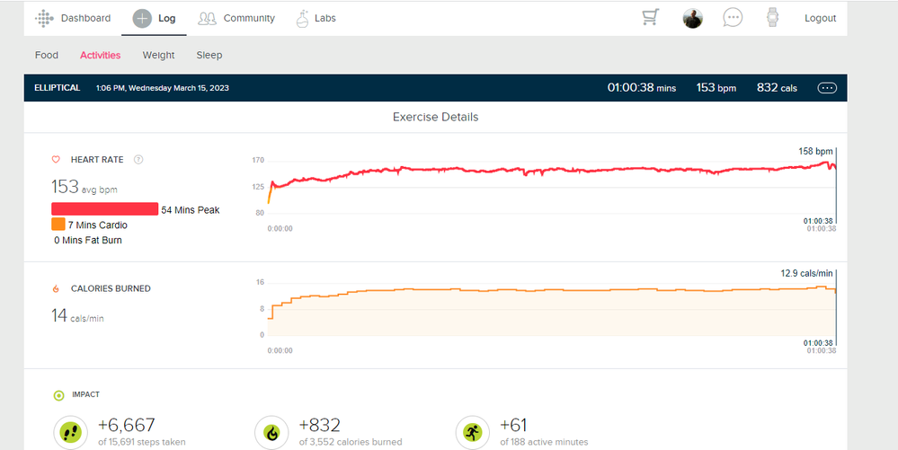

03-15-2023 14:09
03-15-2023 14:09
I had 1 hr of peak while rowing for an hour (13356 meters) and my average heartbeat was 153 while on max was 169. I am 60 years old and after today's exercise, I took also 1 30 minutes on the bike. then lower heartbeat rate down to 130 in average.
I was litle bit nausea when I came home, it toook litle bit longer for heart to get down to rest puls to 60, but now, 8 hrs later I feel fine. I also wonder how this type of training will have of effect. Tomorrow is another day, but then weights and a little bit easier.

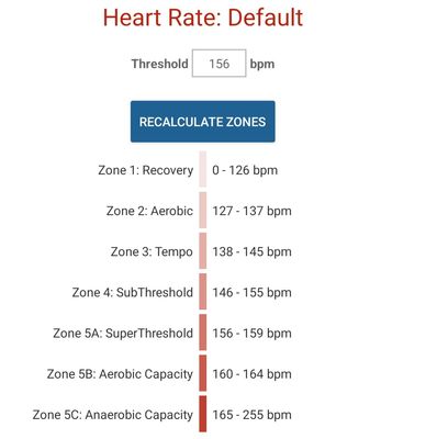

@Kimste if you can spend that long near your max HR then it means one thing - this isn't your max HR. Your max is higher. If you are able to spend an hour within some HR range putting more effort into it then it's most likely within your lactate threshold (often called zone 4). Looking at HR chart I see quite a steady effort.
Let's say that 156bpm for this steady effort is your LTHR (without running math on your actual HR data I can't define LTHR but I can assume that it is somewhere between average and max recorded so I approximate it). So for 156bpm your zones would look like this:
How does that translate to your effort and Fitbit zones? Peak should start around 160bpm but you may include super-threshold into it (156bpm). Cardio is most likely between Aerobic/Tempo up to threshold zones. Everything below is Fat burn. On Fitbit, you can't fine-tune your zones so (I do that) adjust max HR so the Cardio/Peak threshold falls at your LTHR (156bpm).
This will give you much clearer readings. Don't worry about your age. This activity would fall entirely into Cardio zone which would look correct considering it's length and steadiness.
I can't be sure whether 156bpm is your threshold (there are ways of finding it but without actual data I can only estimate based on information you provide) but that would look more or less alright.
If you set your zones like this:
It will give you quite a good (more realistic) model. Under Fat Burn will be your Recovery and easy aerobic, Cardio will start near Aerobic zone and your Peak at Super-Threshold. That's probably best estimate you can get out of Fitbit.
Feeling exhausted is normal after such effort (especially if you didn't fuel yourself during it - for a long endurance workout (and that was endurance workout) you need to fuel yourself or you'll just hit a brick wall). If you plan to go this hard (tempo/threshold) for an hour and more you need energy for it (before, during and after workout). Such workout is like a race effort. It will affect VO2Max and anaerobic threshold rather positively. There is nothing wrong with it. It may as well be a tempo effort if done at the lower end of (new) Cardio zone. You don't want to go into threshold too often though as this will be just counterproductive (depends on activity, risk of injury may increase or in the middle you'd just run out of power, will feel slugish etc.).
