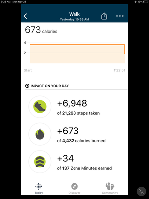

I've noticed a strange occurrence that I'm sure has been noticed before by someone but I cant see it mentioned here so I'm gonna post this. Bear with me as it takes a bit to explain properly. Everyone seems to acknowledge that most activity trackers are not reliable to use for number of calories burned for walking or treadmills, if u use the actual activity tracking aspect of the tracker. Most calculate calorie burn too high, some calculate too low. That seems to be generally accepted. Whats puzzling to me is that if I go into my fitbit app and then manually "add" the same activity as a "logged" activity, starting at the same time, for the same amount of time and for the same distance, the calorie burn number that the fitbit app then generates is much closer to the number that every other calorie burn calculator available generates. And since i used the same start time for the "logged" activity, the fitbit app replaces the numbers (both steps and calories burned) in my daily totals with the closer to correct numbers in the daily total on the dashboard. This doesnt affect my BMR which is the same in both cases. So i know that if i add a "logged" activity that mirrors any "tracked" activities, the calories burned will be adjusted by the fitbit app to be more realistic. Of course this is a PITA to do, so after several days of testing I've found that I can pretty accurately calculate that any calories over my BMR the fitbit app tells me I've burned, if the fitbit is calculating burn using activity tracking (and i dont go in and "log" a "mirrored" activity) can be cut in half and that is a close to accurate number for calories burned for physical activities. This 50% factor works for my activities which are mostly walking based (walk, treadmill). The correction factor may be different for other activities.
The most curious part to me is that the fitbit can obviously calculate a closer to correct number for calories burned walking because when I manually "log" the activity, the calorie burn number is pretty near accurate when compared to other calculators available (and yes these other calculators ask for factors like age, weight and pace, so they are fairly reliable). Why, then, is the number of calories so far off when the app does the original calculation using the activity tracking? And this has nothing to do with the numbers for my BMR. I will illustrate with screenshots.
Yesterday i "tracked" a couple of walking sessions. Today i went back to yesterday's dashboard. it said i had
21,298 steps, 9.84 miles, burned 4,432 calories, 137 zone minutes.
This was before i mirror "logged" any activities. So to illustrate the phenomenon i'm talking about, I'll use a walk I took at 10:33am yesterday. The fitbit app tracked me starting at 10:33am, walking for 1:22:51 min, for 3.23 mi.. The app calculated i burned 673 calories. Then I went in and "mirror logged" that same activity. I manually logged an exercise session, "walking", started it at 10:33 am yesterday, for 1:23:00 min, 3.3 miles (actually 9 seconds more and .07 miles further than the tracked activity). for this manually logged activity the fitbit app calculated only 328 calorie burned. The app also adjusted my daily totals on my dashboard for the day since the app was now using the logged activity numbers instead of the tracked activity numbers. Now my dashboard for yesterday had:
21,326 steps, 9.89 miles, 4087 calories burned, 137 zone minutes. The calorie burn number for the day was 345 less, the actual difference between the number of calories burned calculated by tracked activity vs number of calories burned calculated by "mirror" logged activity.

Yes I realize that. If the calculation using less data is closer to correct, then that is what I want to use. Are u saying that the fitbit burn rate using the activity tracker is closer to correct? I use Fitbit in conjunction with a calorie counter, Loseit! If i just use fitbit's burn rate from the activity, the fitbit way over calculates the burn rate. When i use the burn rate from the logged activities instead, my corresponding weight loss (or gain after Turkey day) all fall right in line. The proof of the over calculating is in the weight loss or gain. If i would use the initial fitbit burn rate from the activity I would be misled as to how many calories i burned/calories i could consume based on burn and still be on target weight wise. To lose 1 lb a week u need to burn 3500 more calories than u consume that week. That formula doesnt work if u use fotbit's non-adjusted burn numbers.That's only because the fitbit is overestimating the burn. But fitbit isn't alone with that problem. It seems most trackers have a similar problem
