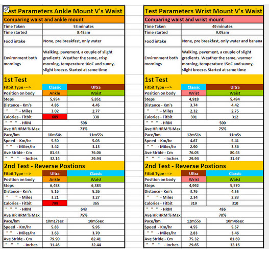

@DelDaveI would like to see your dual testing because I need another Fitbitter to confirm my testing where the further from the torso you move the Fitbit the higher exagerated the calories are. I can generate VAM on an exercise ball and others the same thing on a mini trampoline. The Fitbit filtering is designed for torso mounting for the clip ons and wrist or pocket mounting for the wrist type.
Here is my testing using dual Fitbits last year
Colin:Victoria, Australia

@DelDaveThat was my ambitious attempt because there were many posts and at the time when the Dashboard changed from the original Dashboard and to the tiled Dashboard. Also the Fitbit baselines changed to mirror the CDC Guidelines. I was getting close to 100% VAM before the changes and now I struggle to get anywhere near that my BMR hadn't changed to affect the result.
I also ran some other tests and they were documented in a different way. here is the link
Lately I have noticed I'm getting some VAM for day to day walking, not planned which is odd. Maybe Fitbit has changed something. I purchased the Zip as well because others were opting out of competitive groups based on Active minutes if they did not have a Zip. For me the Zip gives nearly 3 times the VAM as my Ultra and One. I proved that and I notice in the Help topics Fitbit say that their trackers will give different VAM results.
Looking forward to your results and the retired engineer in me has me testing these things. Keeps my brain active.
Have a good day.
