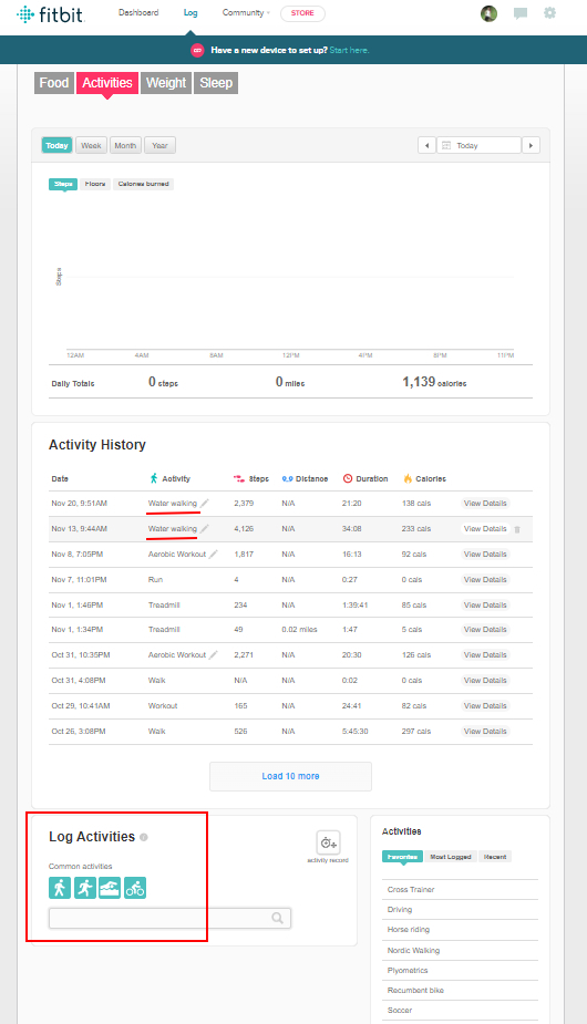

As an alternative, you can create a custom activity on the Fitbit.com Dashboard > click on the magnifying glass > type 'Water walking' > click on 'Create custom activity' > click on 'Add Activity' > then you will have the option to enter date, time, duration, distance and calories burned. Once you've created a custom activity, you will see it under 'Favorites'. So next time you want to add this activity, you just need to click on it.
