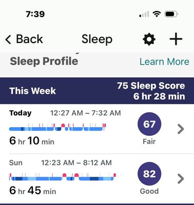

Thank you for chiming in. Update: It’s been 14 days since the time change (daylight savings in NC on Nov. 5). I wear my Fitbit all day and night, and only take it off to bathe and recharge. Since then, the following has happened:
1. Readiness score has not returned. When I tap on the tile, it says the score is not available and to make sure readiness is turned on in settings. I have scoured settings. There is no option to turn the readiness feature on. Under “manage features”, readiness no longer appears as a turned on features. I did not turn it off! The only thing I can find online as instructions to start it is to tap the tile and follow set up procedures. There are no procedures.
2. My sleep function now records 2 overlapping scores per night. It names the first as the specific night of the week being recorded. It names the second as “today”. For example, last night it says Saturday, 10:48 PM to 5:30 AM, and next, it says Today, 12:15 AM to 8: 22 AM. Two overlapping sleep scores. To be clear, this happens every night, even when I go to sleep before midnight. Other nights, it says I’ve only slept 2, 3, or 4 hours, which is never true. In addition, I have a bedtime alarm set and it no longer notifies me.
I’ve contacted support via chat 3 or 4 times and get the same run around every time. I waited 24 hrs. No fix. I waited 4 days. No fix. I have deleted and reinstalled my app. No fix. I have logged out and back in. No fix. I have turned my Fitbit off and back on. No fix. I have turned my phone off and back on. No fix. My app clock is correctly set.
What else am I supposed to do?!?!? I’m in the 6 month trial period for Premium that came with my Inspire 3. If this issue isn’t resolved, I won’t pay to keep premium.

11-20-2023 04:49 - edited 11-20-2023 04:52
Here’s last night (Sunday, but technically Monday morning after midnight). Cannot figure out what is happening! You can see it was only 7:39 AM, but one of the scores says I slept past 8!
