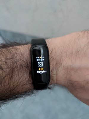

If this troubleshooting steps don't work. Could you please send me a picture of the grayed screen in order to further investigate?

I have the same issue, here a pic of the recurring alarm greyed out
