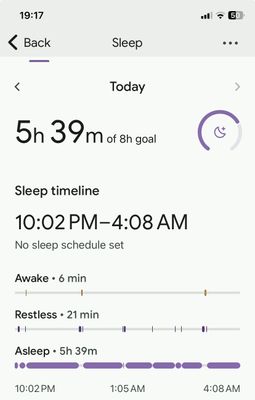

Fitbit used to give that to me, but around the same time, sleep was categorised into Awake, restless or asleep. See last night’s data: (an early start to the day)
Was the Inspire 3 firmware updated to 210.26 in mid-December of 2024 also?  If so, that may help to explain why you stopped getting sleep stages then as well.
The 210.26 device firmware implemented a new heart rate measurement algorithm that reportedly measures heart rate more accurately, but doing that also appears to make measuring Heart Rate Variance much less reliable if one has any sort of heart arrhythmia, and a good HRV measurement is required to get sleep stages.
My wife has frequent Premature Atrial Contractions (a type of heart arrhythmia) and she has rarely gotten Sleep Stages and most of the Heart Metrics returned since her device was upgraded to the latest 210.26 firmware.  I keep hoping that Google will do something to resolve that HRV measurement issue, but that hasn't happened yet.
