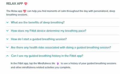

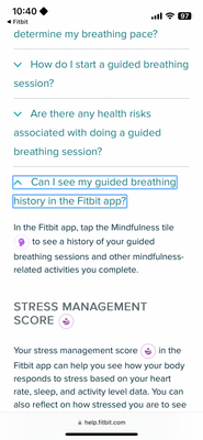

It also confuses me because i found this:
08-22-2023 21:42
08-22-2023 21:42
As discussed in this topic:
https://community.fitbit.com/t5/Other-Inspire-Trackers/Can-I-see-a-history-of-the-Relax-app-sessions...
Relax app sesssions are not being logged into the app as advertise here:

Hi everyone, and welcome to our new members!
Thanks for the detailed information, and the screenshots provided. I'm sorry if this caused any inconvenience. Let me share this has been escalated to our team so they can work on this. Once I have more updates, I'll let you know in this thread.
In the meantime, please make sure to keep your Fitbit device and Fitbit app up-to-date so the rest of your details can sync correctly.
