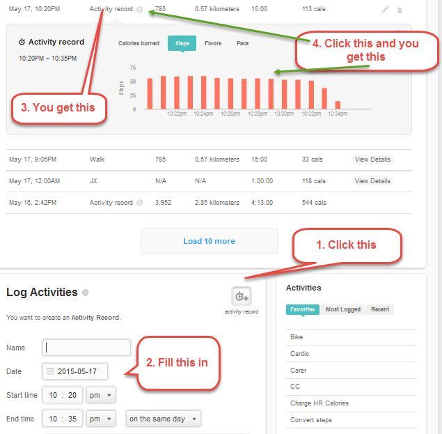

You can see that if you click on the Activity Log on the PC Dashboard, select the Active record icon with the small stop watch and enter the same times as your walk. This will give you a minute based vertical barchart when you select calories. That will show if there is a lag in the 11 minute activity.
This is a copy of your data so it will not change anything

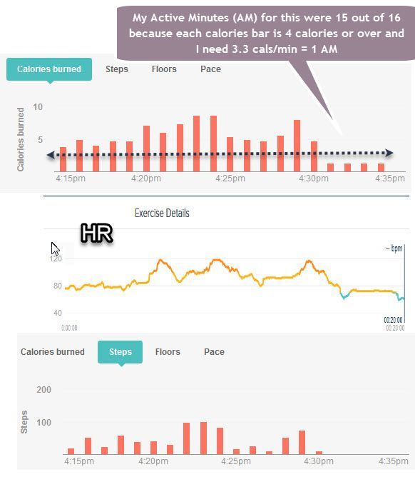

@Camilla_RApologies, I didn't explain myself fully.. Your 51 calories is definitely well into the Active minutes area. When we say sleep BMR we anticipate that you would look at your Activity Log on the PC and click calories and get the graph.. These are in 5 minute graphs so divide the single graph by 5 for your 1 minute BMR or better still use this calculator which uses the same equations as Fitbit and divide the answer by 1,440 minutes in a day.
The last graph has a Very Active Minutes which is 6 times and greater your BMR
Here is an example of what you should have seen in the Active Record graph.am test 15oct17.jpgActivity record steps.jpgactive minutes for Fitbit users.jpg

If you follow the steps for the Active Record post earlier you will probably see the issue.  Fitbit claim they don't discredit us if we pause to cross a road etc.
In your Activity Log for the day for the 11 minute walk did it show any 5 minute bar as green or yellow as per image below.. These graph bars are 5 minutes.  Use link
