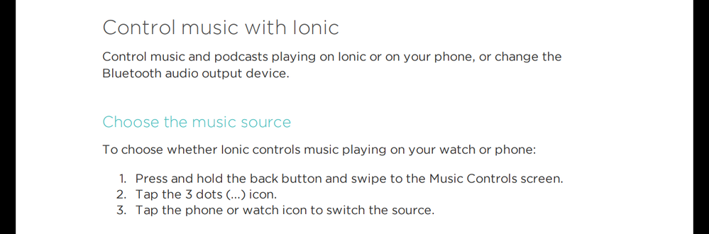

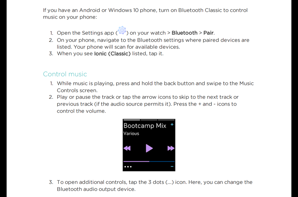

You should also be able to control the music on your phone with your Ionic. Have you tried the following steps?
I believe the step involving the Bluetooth classic isn't required if using an iOS device, so that part only applies to Android and Windows phone.

Thanks for the response didn't know about the music settings wish my ionic came with actual feature overview instructions but I got nothing.
Anyway I do remember reading the response is coming out and that's great hopefully they overhaul the notification area especially how the new messages stack on the bottom and the clear all is at the top forcing you to scroll through all your messages to delete or clean them up.
Secondly I have the music classic now setup what it doesn't mention is to keep the option at pair in settings to connect it (mine switched to on as soon as i clicked the classic and it didn't connect until I flipped it back to pair) but it's connected however it doesn't recognize anything, the watch shows a green phone and says start playing music to which I tried playing a podcast with the app pocket casts, no change, tried music through my plex app no change, finally tried local music using poweramp and still no change. Will continue to mess with it.

Update for music got it figured out apparently if nothing is showing up on the watch you may have to go back to the previous screen with the selection of watch or phone(screen after clicking 3 dots) then toggle watch then phone again and it should appear and work.
