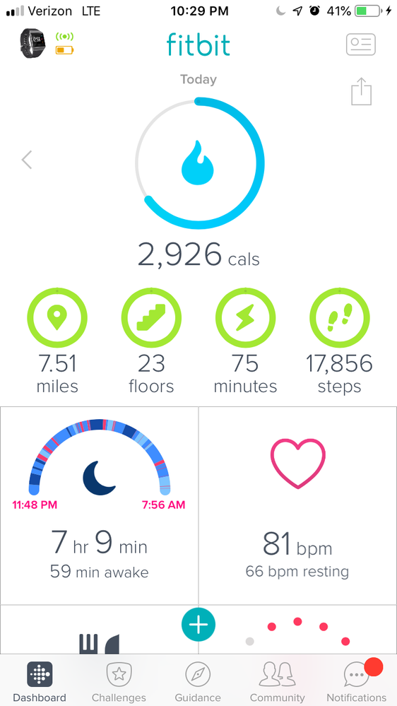

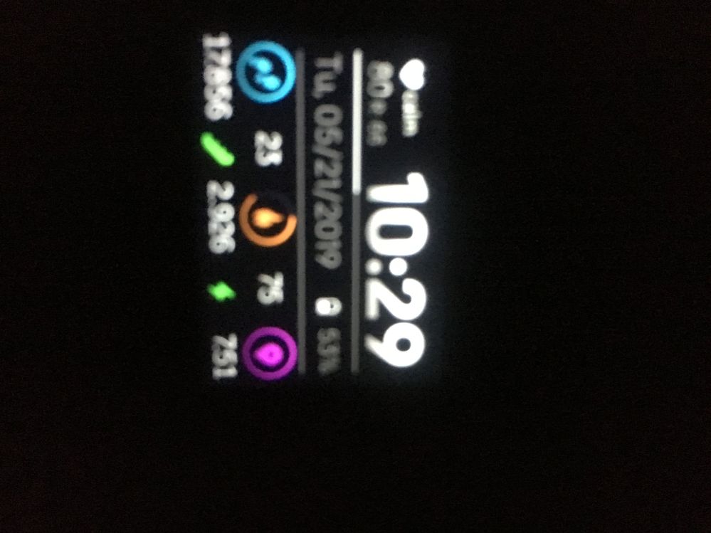

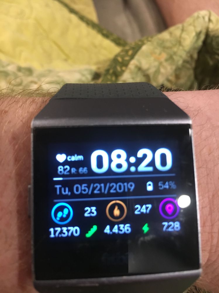

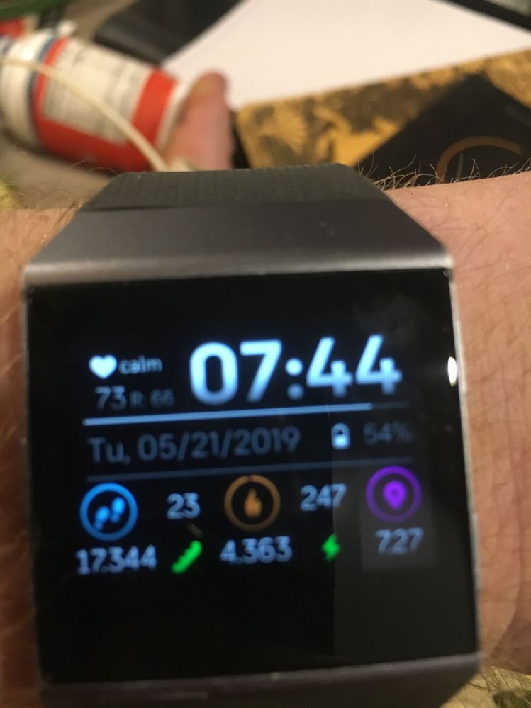

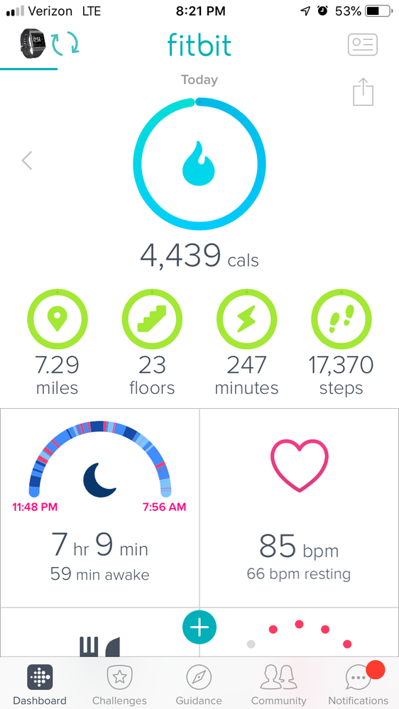

UPDATE: (5/22) contacted customer service... If you're having any similar issues.. Report it to customer service as it seems to be a glitch in the app and /or firmware
UPDATE!: (05/21)
It just did it again.. This time the fix isn't working... This looks like something that the developers need to figure out.. Posted screen caps below
UPDATE!:
"Solved" but still think that this is a glitch that the fitbit folks should investigate for some future update... I'll report back if it happens again with screen caps and whether the fix still works or not

So the issue returned again tonight.. This time was just randomly... I did notice the lower figure was first in the app but not on the tracker.....a second or two later, I then watched the number drop on the tracker..
This seems like an issue with the app? Maybe someone one(a developer) needs to look into this... Especially as it occurs for other people as well
