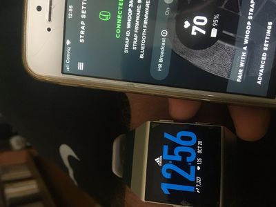

Yes, watch faces can reduce the battery life, that is true, but that is not the case for me. I have the adidas edition, so i use that since day one. (I changed it once maybe for a day) Simple,basic and I love it. I do have the same setup on my watch, i do work out as often as before, yet one day from another suddenly my battery drains super quickly. I’m 99% sure it has something to do with the latest firmware update. Heart rate, calories are way off. Unable to track my sleep 9 out of 10 times. I think something happened with the sensor and that’s why the battery dies after a day. In fact I checked back on the data and around the upgrade, the watch cannot pick up my hearth rate sometimes, huge chunks are missing, and i wear my watch properly. Other times when I’m sitting it shows 120 bpm which is ridiculous.
