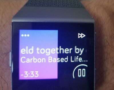

@SunsetRunner
I have a Samsung Galaxy S8, using Google Play Music, and I see the artist on the Ionic just fine. Also, it doesn't matter if I am using my own music, or one of their stations. Might want to verify your music actually has the all those properties set (title, artist, etc). And note, Google Play Music has messed up some of my music when I added it to my phone, and a few of my songs do not show any information. Mostly, though, it's fine.

@SunsetRunner
All I can tell you is, at least with the way my phone is set up, I can control Google Play Music (via Ionic (Classic)), I am getting notifications, AND I see the artist name. It is happening right now. I just got a text while listening to music, and I checked to insure that i can still see the artist.

FWIW - I usually start Google Music first on the phone, then go into the watch (swipe down, tap three dots, select Device) and that takes control, and the title and artist is then available.
