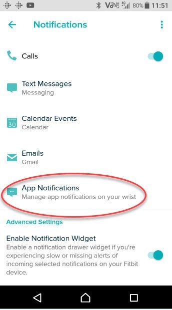

Have you all gone into App Notifications as well

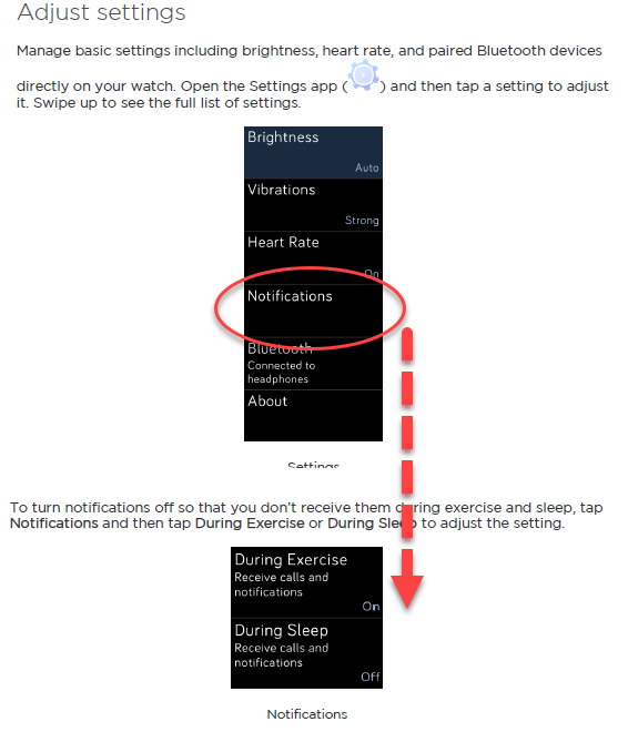

Here is a link in another topic searching for answers as well.  My large posting was yesterday... with Images...
Also an overlooked option on the Ionic itself  From the clock face screen swipe left to right and you get this.
Also in settings..
